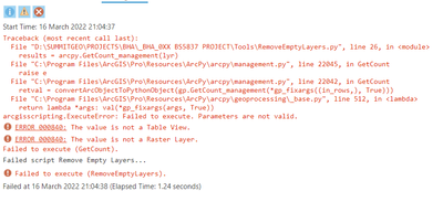

@JakeSkinner thanks for the example, but that returns an error
any ideas?

Replace the print statements to arcpy.AddMessage instead.  This will print which layer the script is failing on, and this should give us some insight on what's going on.  Ex:
arcpy.AddMessage(f"\t{lyr.name}")
