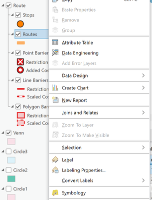

You can change the symbology of the Routes sublayer within your analysis layer.  Expand the analysis layer, right-click on the Routes sublayer, choose Symbology

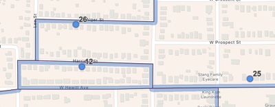

Also, I sometimes Buffer route lines using "Right" for the Side Type parameter. If you display the buffered line with the route line, you get a sense of how how the route is traversed, like this:
