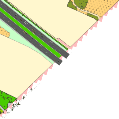

I'm using a custom elevation raster (1 meter cell size) for a polygon layer in a scene. When I zoom out, AGP lowers the surface resolution drastically, leading to cut off polygon edges - see GIF below. Can I somehow prevent this? It doesn't happen in ArcScene (which on the other hand doesn't drape the polygon over the surface as nicely as AGP).

Recommended solution is to use TIN, if you want to keep surface resolution constant
