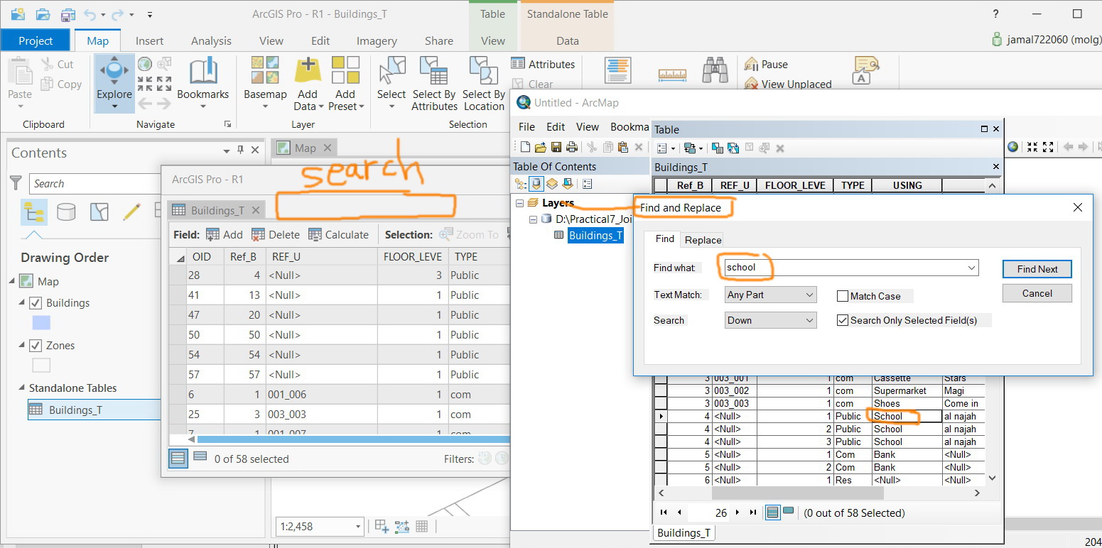

Is the “find and replace” tool available in the latest version of ArcGIS Pro,
8071
36
11-17-2017 12:24 PM
JamalNUMAN
Legendary Contributor
Despite the fact that there is a workaround for this, however, this tool is heavily needed as it is considered the main SEARCH tool. What is the point if searching the data is not straightforward?
FAQ: Is the Find and Replace tool available in ArcGIS Pro?
https://support.esri.com/en/technical-article/000014591
Jamal Numan
36 Replies

Dan Patterson‌ and Jamal NUMAN I can confirm I too observe this behaviour, the find and replace tool does not appear with a standalone table. It is a bug in ArcGIS Pro 2.5.
There is a work around, open an attribute table for any layer in your map THEN open the standalone table and then you will see the find and replace tool...

Duncan, I did it with a clean project, just a standalon table, I followed my images (there are several) and it has worked with several different tables in several existing or empty projects.

Jamal NUMANDuncan Hornby‌ thank you for reporting this behavior. I was able to reproduce this in-house. I have created a support issue as well, so you can track the development status: BUG-000129280.

Alycia Rajendran‌ what did you have to do to reproduce it, when I can't?  Data source? License? Proximity to Greenwich?
AlyciaRajendran_esri
A lot of pizza, of course!
It appears to be a timing issue. Sometimes, standalone tables take longer to initialize. At the same time, that menu is being initialized and it looks like they can get out of sync.
My repro was this:
1. Open two maps, side-by-side, one with a standalone table
2. Give focus to the map without the table by clicking its tab
3. Give focus back to the map with the table and open it
I had more luck starting from an Untitled project and inserting two maps, docking them side-by-side, and then adding the table.
