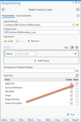

Perhaps I'm just looking in the wrong place or using the wrong terminology in my queries, but is it possible to update attributes to "use ratio policy"? I can't seem to find anything anywhere. Several Esri tutorials talk about it and reference enabling it, but nowhere is it explained how to do this? Could someone shed some light or point me in the right direction?

In the Make Feature Layer GP tool:
And from the documentation:
A split policy can be set by using the Field Info control's Ratio option. The split policy comes into effect any time the feature layer is being used as an input to a tool and a geometry of the input feature layer is split during processing. When the split geometry is sent to the output, a ratio of the input attribute value is calculated for the output attribute value. When Ratio is enabled, whenever a feature in an overlay operation is split, the attributes of the resulting features are a ratio of the attribute value of the input feature. The output value is based on the ratio in which the input feature geometry was divided. For example, if the input geometry was divided equally, each new feature's attribute value is assigned one-half of the value of the input feature's attribute value. The Ratio policy only applies to numeric field types.

That's what I was talking about. Several mentions of it, but nowhere does it say where to enable this. I found at least 6 help documents all referencing it but there are no further details other than saying that if it's enabled then the attribute values will be divided along with the polygon. I can't seem to find where to enable this anywhere.
Edit: did a search and got 10+ results all with the same "However, if the input is a layer or layers created by the Make Feature Layer tool and a field's Use Ratio Policy option is checked, a ratio of the input attribute value is calculated for the output attribute value." They are clearly copying/pasting this into each of these documents without any guidance on how to do so... kind of agitating...

AdamBowen
Thank you so much!
