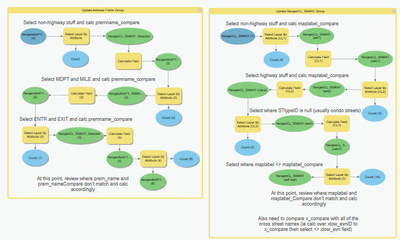

Thanks for the reply @DanielFox1 .  Can you clarify what this means?  "remove the input link to the other groups"  I don't have any connectors between the group, if that's what you mean.  See image below showing 2 of the grouped models in the model tool.  Thanks.

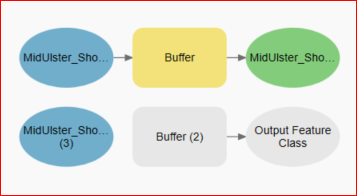

In the screenshot you provided if you only want to run the group/model on the left then with the group/model on the right remove the input at the start and reconnect when needed. You can see in my example the greyed out workflow as the initial connection has been broken.
