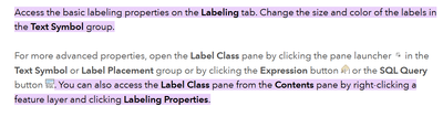

if you are talking about county names as Labels then yes. The link below help, cheers.
Labeling basics
Labeling basics

Simple labels can work too
Bring in a county later that has names bas attributes
Make the boundaries themselves hollow with no outline if you just want the names to show
Then play with the labeling properties
Good luck 🙂
