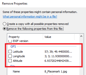

ChrisUnderwood
@Lee-Collier  This GPS section is completely missing from the Properties > Details section for the Trees2 file.
If you are sure your iPhone is setup correctly, could there be some sort of post-process occurring that is stripping away that metadata ?
