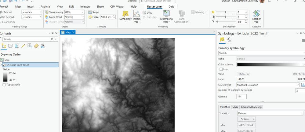

Here is an example for a default setting for a raster added to the map:

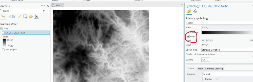

Clicking the invert option simply inverts the symbol as shown below, but not the labels:

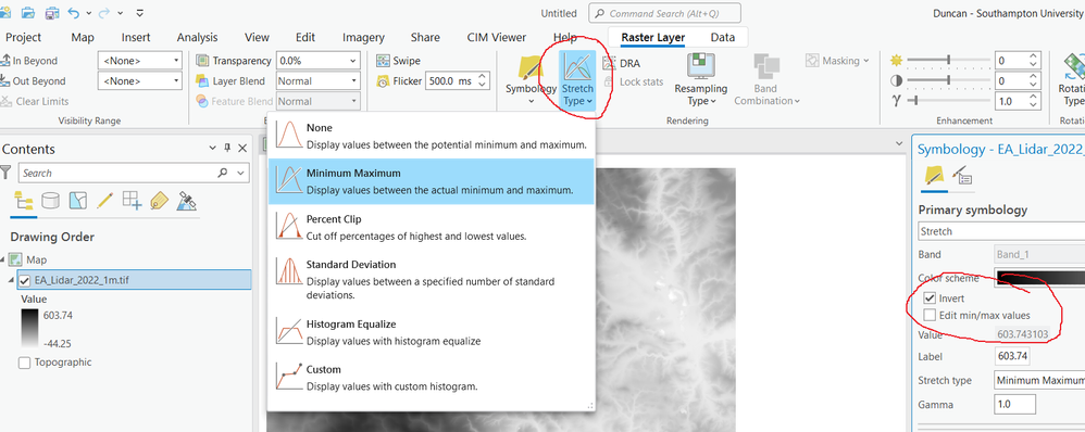

You need to set the stretch type to min/max, note new tick box options appears in symbology pane.

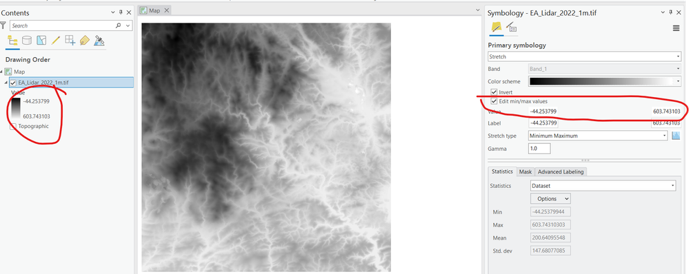

Tick on edit min/max values, swap the values around and hey presto you get your low - high labelling as desired
Although I show you a solution I think in the case of this elevation dataset it does not make sense, so be careful when inverting values/labels to make sure what you are showing is understandable to the map reader.
