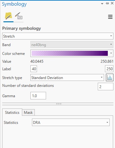

I have a raster layer in ArcGIS Pro that shows values from 250 to 40.  I want to know how I can invert the values so that 40 is at the top and 250 at the bottom.  See attached image.

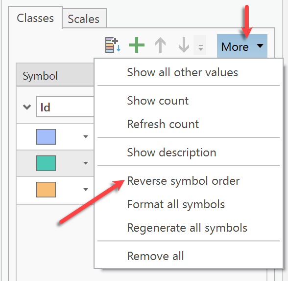

reverse symbol order?

Hi Dan,
Thanks for that.  Unfortunately that won't work as the raster is displaying as a stretch type, please see image.

Then No....you will have to skip stretch,
you can choose 'classify', choose a method, then under 'More', there is a 'reverse order'
