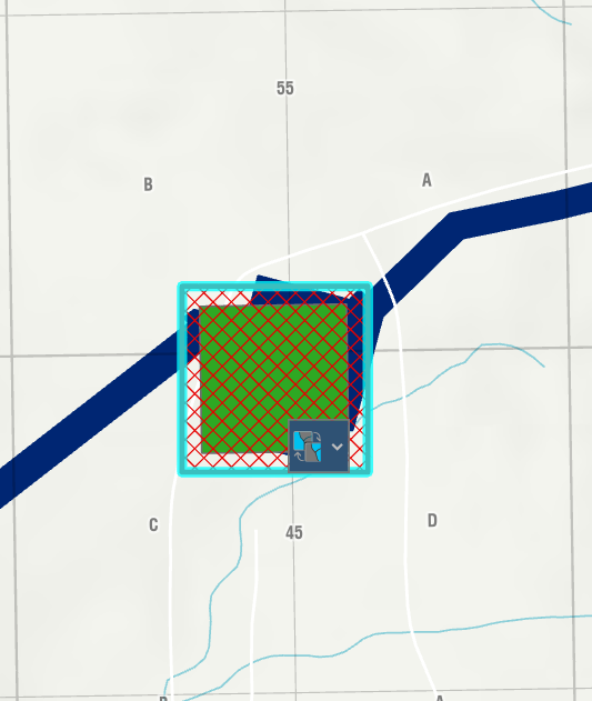

I have a lot of 250m square polygons, and I want to add the location based on a grid I have to an attribute table field. How do I set the intersection to use the center of the polygon? I've noticed sometimes it pulls the grid location from the upper left of the 250m polygon, but I want it to use the center.
Example image below, it populated it with B-55, but it should be C-45

Hey @IanLadd_Tourmaline
I know this isn't a direct answer to your question, but you can use the Feature To Point tool that will create a point at the direct center of the polygon, which you can then use to run your tool, I used this on a similar issue where the center of a polygon was very important.
Cody
