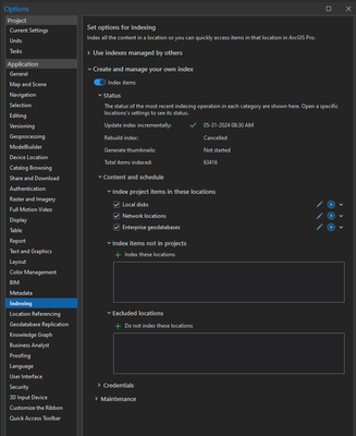

Another update. Version 3.2.2 has reworked the indexing tab in options. Things seem to be working except after I hit start and it shows indexing in progress, when it finishes (I guess) it says the process was 'cancelled'. I am however getting search results, even after a reboot, which is great! We'll see if this holds up.
