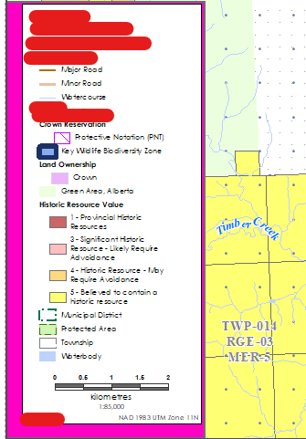

For those unaware of the "trick", in layout view if a label is in an undesirable spot (say it's a label cut off by the legend), a quick fix to this was to activate the data frame, then draw in a rectangle in the default annotation layer. The rectangle then acts as a label weight and moves labels away from that area. So you could make a rectangle annotation slightly bigger than the legend, make the symbology invisible, then labels would no longer get cut off by the legend. Example below.
The "Timber Creek" and legal land labels were being cut off by the legend. The quick fix was too add the pink polygon as an annotation layer in the focused data frame slightly bigger than the legend. This acted as a label weight and pushed those labels out so they were no longer cut off. The pink polygon can then by symbolized as invisible.
