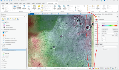

Simonez
I am also having image issues ov several kinds. By zooming in and out, the image can totally disappear. Another problem is what happen to the right side of the map view (see enclosed) which I don't even know how to explain... . I didn't have any of this issues with the previous version. Any help would be appreciated.
