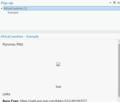

Attempting to configure embedded image in pop-ups for a layer in Pro
When using an image URL (flickr and imgur) inside of a pop-up it does not show up in the pop-up. Only a small picture icon will display. Does anyone know why this would happen? Does this with all layers and all different URLs attempted. HTML mode doesn't make a difference.

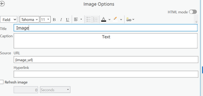

I just tested this out in ArcGIS Pro and did not have the problem you are reporting. My popup configuration looks like this:
 "{image_url}" being the field that is holding the url to the image.

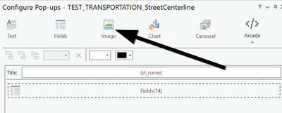

Just for clarity, are you using the 'Image' button at the top of the popup configuration dialog?
