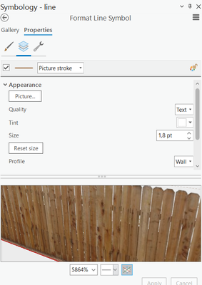

ArcGIS Pro Picture and 3D Symbol combination

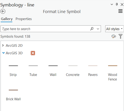

With ArcGIS Pro Default tools, you can create a fence by modifying the Wood Fence picture line marker:
Under Picture you can provide a PNG file of a fence with transparency.

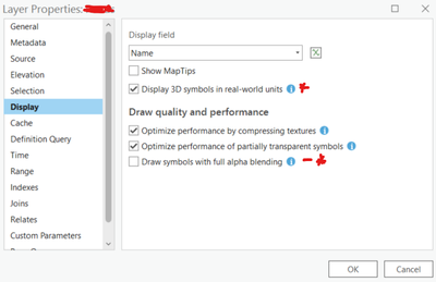

Don´t forget to adjust the Layer settings:
Enable Display 3D symbols in real-world units
If necessary enable Draw symbols with full alpha blending

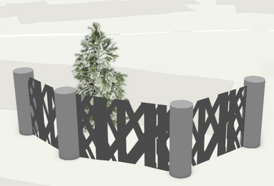

Now convert your line that is used for the fence to points and create poles (or load your own 3d model):
