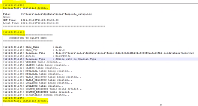

on one of our machine, we are facing this problem too. When the PRO is tuned on, ExcelToSQLite process from PRO Bin folder each 30 seconds writes a new runtime geodatabase to TEMP folder and log it to he sde_log file. The process runs periodically - it starts, writes the log and geodatabase file and close. And this repeats every 30 seconds.
It´s weird that each run ends with a note Succesfully installed ArcSDE. The content of these geodatabase is different all the time and refers to some old tranasformations from Excel to Feature class. When the PRO is turned off, this process writing for a while, so it doesn´t seems to be related to the main ArcGIS PRO.exe process, but more likely to indexing service (just an assumption now).
