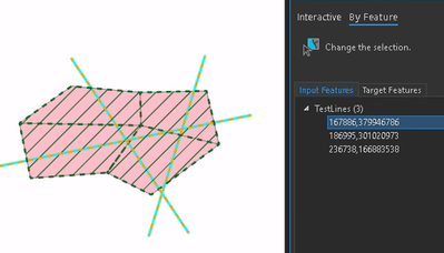

You can use the Split edit tool to split features with other features.
Here, I'm splitting 4 polygons by 3 polylines:

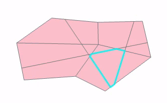

Result:
