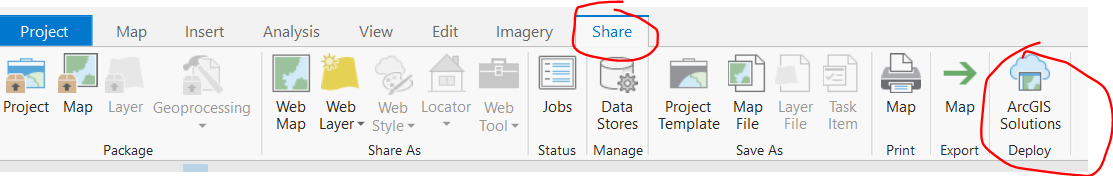

Currently, this isn't possible directly in Pro.  But you can download and install the ArcGIS Solutions Deployment Tool | ArcGIS Solutions
In Pro, launch the tool from the Share tab:

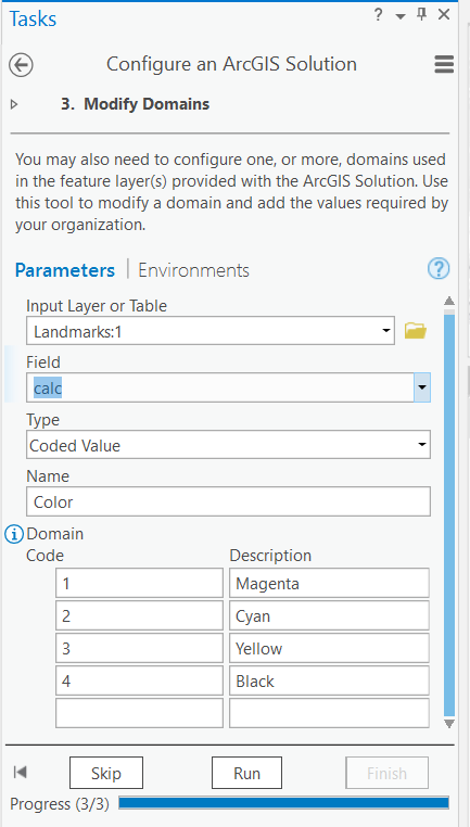

and in the tasks go to 3. Modify Domains:

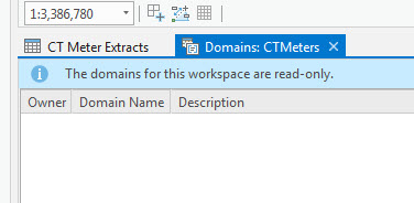

I used the tool you suggested and it helped me add and modify domains to my HFL.  Thanks!  However, I'm not able to work with them in the attribute table in Pro.  There is a message that says "The domains for this workspace are read-only."  I can only see the domains when I'm looking at item in AGOL.  Is that a known and intentional limitation?

This is a known limitation, currently.  There is an idea here https://community.esri.com/ideas/12962 .
It is functionality that our dev teams will be working on and I'm sure we'll see a more seamless experience in a future release.  Hope this helps!
