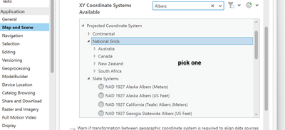

You don't need to create one if you know where it is for... pick one
