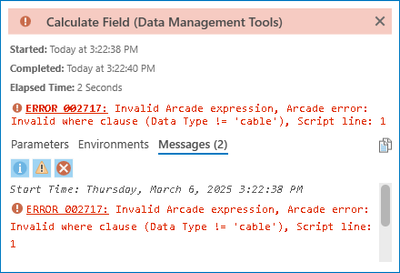

cepotts
Here is the actual error message:
KenBuja
MVP Esteemed Contributor
You have to use "<>" instead of "!=" in SQL statements
var filteredFeatures = Filter(relatedFeatures, "Data Type <> 'cable'")
cepotts
Thank you for the response.  That is one of the variations that I tried.  It still returns the same message.
KenBuja
You also have a space in the field name, which is probably its alias. Use the actual field name.
cepotts
Thank you!  I did try that in other variations, but it was likely in completely different things that I was trying at the time.  I probably also still had the "!=" operator in there when attempting it.  Much appreciated!
