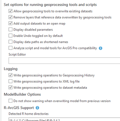

Project backstage, Options, Geoprocessing, Logging
Do you have anything checked on?  If so, check them off, delete the .pyHistory and try again.
I can't find any of them on my system.

These are the only options turned on, none of which I want turned off.
I have worked out I can delete the .PyHistory manually but I wondered if there was some buried option that stops it from being created in the first place?
