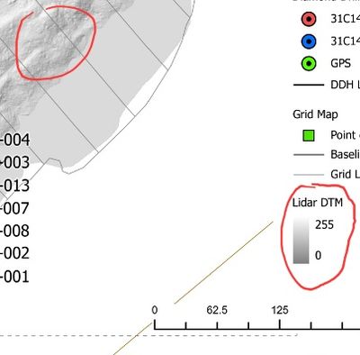

A while back, I made a map that had a greyscale Lidar DTM raster in it, and included the Lidar layer in the legend.
When I look back at the map, I'm wondering if the 0-255 label in the legend is perhaps not very useful. Does 0-255 pertain to color values, not elevation values? Would it  have better to somehow show what colors pertain to corresponding elevations?
What's the proper way to show a Lidar raster in a legend? Or is it better to leave it out of the legend? It’s been roughly 10-15 years since I made a proper PDF map, so I’m rusty.

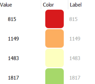

@DanielFox1 Also, another idea:
“Continuous raster symbology in map, but discrete color swatches as legend”
Map:
Legend:
Image source: https://gis.stackexchange.com/questions/388154/how-to-get-back-discrete-raster-legend-symbols-in-qgi...
Does that idea make sense?
Edit: @JesseWickizer Do you see any obvious issues with this draft idea before I post it publicly? Thanks.

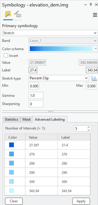

JesseWickizer
@Bud you can do something similar with stretch raster symbology by using the Advanced Labeling settings.
