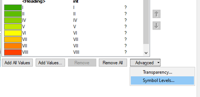

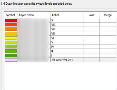

You should use symbol levels from the Symbology tab. Check to draw using symbol levels and sort categories:
Arcmap:
PRO:
Hope that helps
