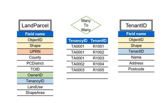

I have connected between 'LandParcel' and 'TenantID' table by 'many-to-many' relationship
I created relation class between them. However, it didn't work well.
I tried to put primary and foreign key differently, but it failed.
When I add to new relationship in 'edit' window, new window indicated that 'there was invalid foreign key value'
How can I put correct set-up and build rule between them?

One thing to check in a M:M relationship class with a Primary Key is it is set to "Allow Null Values."?  If so, uncheck this.  Does the error persist?

I found how to cope with that by creating new tables, then connecting two tables.
