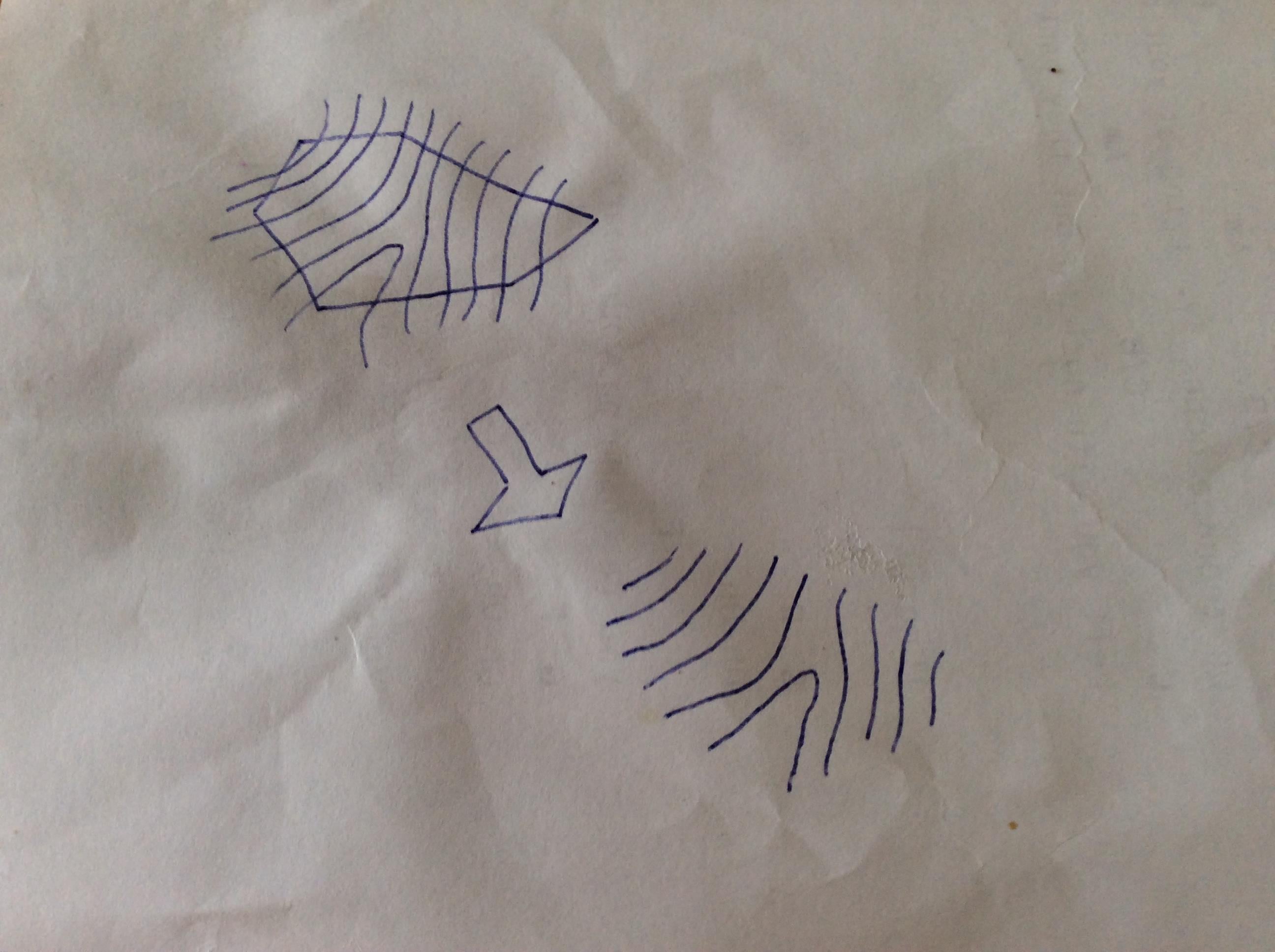

I would like to select lines that exist within a
polygon, and create a new layer with the selected data,  as shown in the image.

Could this be due to the lines not existing solely within the polygon?

If none of the methods of 'selection' are panning out, it may be due to a number of things.
  •  make sure that both featureclasses are in the same coordinate system
  • make sure that your polygon is a polygon and not a polyline
  • nothing works with graphics
that's about it for now since it is difficult to see what you are working with from the screen grab
XanderBakker
Esri Esteemed Contributor
Do you want to clip the lines to obtain only those parts of the lines that are inside the polygon? Clip—Help | ArcGIS Desktop
