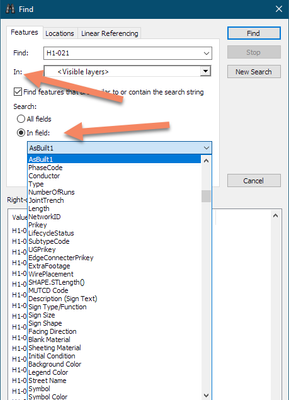

After a long time away from GIS, I'm trying to learn my way around ArcGIS Pro (3.3). In ArcMap you could use the Find tool and select 'In field' to show you all features that had a given value in that field across multiple layers (feature classes). In ArcGIS Pro it seems you can only search one layer at a time with Select by Attributes, as the Locate/Layer Search tool doesn't let you specify the field to search. I am dealing with nearly 100 feature classes, so to search through each one is a pain!
For example, say I need to search my whole project for any feature that has the field 'Surface Type', and the Surface Type = 'Asphalt'. I want to be able to get a list or select all features - whether they are a road line, a carpark polygon, or a sports court point - that have an asphalt surface. I don't want to export all of these to a new feature or gdb, I just need a list like the old Find tool provided.

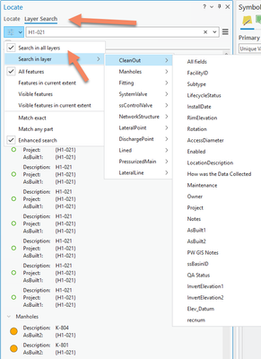

You can use the Locate tool and do a Layer Search:
You can have it only select certain fields BUT, only if you search One FC at a time (see the menu of CleanOut under Seach in layer above).

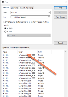

It will search all layers and all fields using the Search in all layers option, and you can change to detailed view to see what FC/field it was found in:

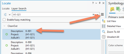

However, it can be a bit confusing.  If you see above, I searched for H1-021 which should be in AsBuilt# or Project field, but it is reporting some other value in the Description (K-891).

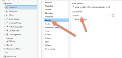

Turns out the "Description" is the display field for that layer, so if you set the Display field to the one you want to search:
then the results are easier to make sense of. (first image above is with Display field set, second one shows default behavior)
You can then select what you want in the results pane and right click, add to selection as well.
