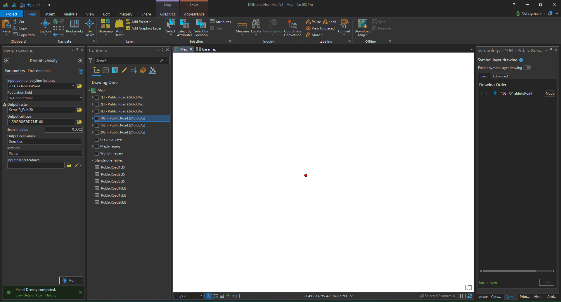

I'm not sure how it got on my map, but it sort have just appeared. I hid everything on the drawing order contents and it's still there. It grows/shrinks as I zoom in/out. Using graphics select and map select does not seem to select it at all. What is this and how do I remove it? Thank you.

Did you use the Coordinate Conversion tool recently? If so, clear the results at the bottom of the panel.

That was it! I've never used the tool before, but must have somehow hit the button. Thanks!
