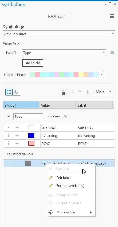

I am having a go at using ArcPRO to create a simple map, I am doing OK right up until I have to create the legend.
Is there a way to filter off and not display the <all other values> from my legend?
I click on the symbology, and right click on this item and I am unable to remove this symbol (this is expected, as I know in arcMap this is the same)
Disabled Option
So, I am sure in ArcPro I should be able to remove this option from the legend, can someone explain to a n00b how to do this please?
unwanted <all other values>
Thanks

In arcmap, I just used to do another hack... but only useful for layouts... which was to convert the legend to graphics... ungroup... delete what I didn't want... regroup and it was done.  Wait!!
Found it

Fantastic, thanks for that... I kept clicking 'more value' thinking thats where you were indicating, and then I expanded my field of view and found the 'more' button you said to click!
Thanks heaps, works exactly as expected.
