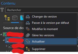

lmatteo
Actually, if you go to the data source panel, then right click to the database name and select "Refresh" it would work. But I'm also looking for an in-script solution to refresh it automatically.
