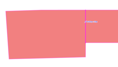

We are in topology map mode. How to move the edge of two polygons f.e. 100 ft to the east?Map topology; an edge betwen two polygonsMap topology; an edge betwen two polygons

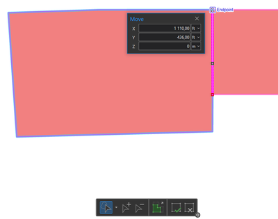

Thank You Josh, I knew this methot but I have a problem with Move tool dialog box, because when I select my node and open Move tool dialog box I have a priori some values assigned (As in picture in my other post above). When I try to write my value f.e. X=100, Y=0, and hit Enter, there is no reaction.

Thank you for your quick and precise answer. Yes, I knew this document and tried to do it, but when I opened the Move tool I immediately had some values assigned to X and Y. Changes confirmed with the Enter key are not reflected in the sketch. I don't know where the problem is?...X, Y values a priori assignet in the Move tool dialog windowX, Y values a priori assignet in the Move tool dialog window
It is probably something wrong with a project settings. When I have creted new project and tried to move of an edge between two features, in the Move dialog window there wasn't any X and Y numbers. Do you have any idea, what is going on?...
Scott_Harris
@TomaszBartus It's hard to tell from here. My best suggestion is to have Esri Technical Support observe the behavior.
TomaszBartus
OK, I understand what the problem was. So far, I have tried to select the entire edge and move all its vertices at once by a given vector. In ArcGIS Desktop this was possible. In ArcGIS Pro, there is probably no such option and you have to select the vertices separately (+Shift) and then you can move them using the Move tool. I did not find the option to select an edge and move it by a given vector (which was available in ArcGIS Desktop).
