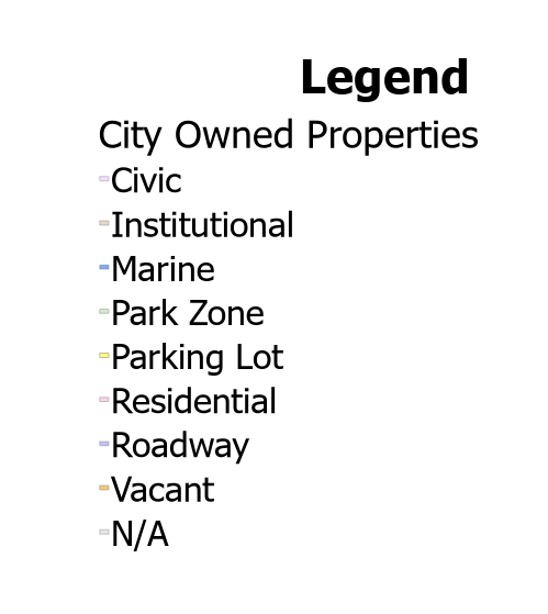

I am creating a large map, therefore the legend needs to be large. I have made the text large, but I can't seem to figure out how to make the polygon symbols larger. I have included a picture for context.
If anyone knows how to help that would be amazing!!
Thank You:))

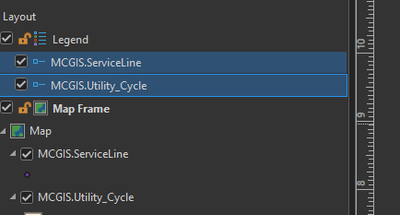

It goes off of the size you have set in the map. I would create a copy of that layer and use it solely for symbology in your legend.
https://support.esri.com/en-us/knowledge-base/how-to-change-the-size-of-point-symbols-in-the-legend-...

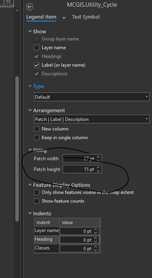

DanPatterson
MVP Esteemed Contributor
legend patch
Change the arrangement and sizing of patches, labels, and descriptions.
Work with a legend item—ArcGIS Pro | Documentation
... sort of retired...
Laura
by MVP Regular Contributor
@aduyvesteyn Dan is correct. You'll want to click on your legend item in the layout and then look at patch width and height!
