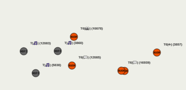

I've got an Arcade expression for labels that works fine in AGOL, but when I try the same thing in Pro, only certain unicode emojis display correctly. Anybody have any ideas on getting them to display correctly?
Here's an abbreviated version of the expression:
var code = $feature.behavior1;
var decodedValue = Decode(code,
'Active Nest','★-',
'Agitated','',
'Calling','',
Concatenate(['T', $feature["ter_id"], '|' ,decodedValue, '|', ' (' , $feature.OBJECTID,')'])
The emojis show up fine in the Arcade Expression box
Here are how things look in AGOL:
And how they look in Pro, some emojis show up fine, but others show up as just a little box:
I've tried changing fonts and some other Label Class properties, but nothing has helped.
I've added the hosted feature layer to a map in Pro, symbology comes in fine, but the labels are shown as above. I also downloaded a fgdb and applied the same label expression to the fgdb feature class and get what is seen above.
Pro version is 2.4.2.
Thanks.

JimmyKnowles
Shaun, that did the trick. Thanks for your help.
