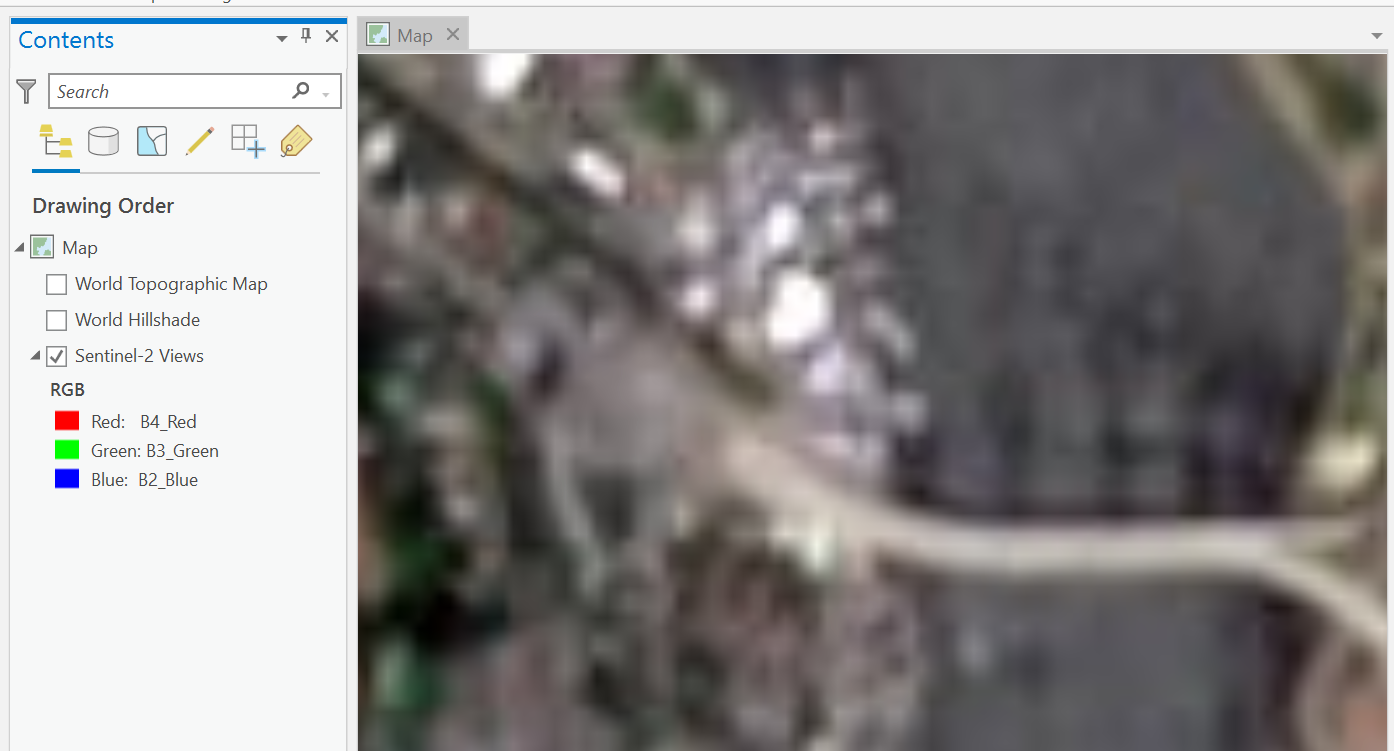

I am trying to do some large-scale deep-learning-based building footprint segmentation. The issue is getting the high-resolution satellite images for input data.
First, I tried "Sentinel-2 Views" from Living Atlas (https://www.arcgis.com/home/item.html?id=fd61b9e0c69c4e14bebd50a9a968348c). But as you can see in the below image, the resolution is quite poor. It states 10, 20, and 60 m multispectral, but my focus is more on the residential area, which often turns out to be 60m low resolution.

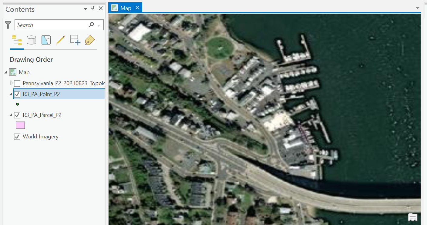

I guess "Sentinel 2-view" is no good for non-major areas and is simply better to use the default "World Imagery" map:

Your second screenshot suggests that you're working in the US so you could leverage USDA NAIP imagery which is 1 meter resolution. Depending on how recent the imagery is for your state, that current imagery may also include a 4th band of near-infrared.
Apart from that, you could also download Landsat 9 data through the USGS EarthExplorer site and create panchromatic sharpened imagery at 15 meter resolution.

My understanding is that different bands have different spatial resolutions. If you are just needing RGB, then those bands should be at 10 m resolution. The 60 m res are for bands 1,9 and 10 (blue aerosol, water vapor, and SWIR-Cirrus).
Sunny
by
Then why are my view at such a low resolution? is there anything to tweek?
WadeWall
Regular Contributor
Sorry, I don't have any information to answer that. I just went and pulled in the sentinel 2 data and it "says" it is 10 meter resolution, but it sure doesn't look like it. It does says that it is still in beta, so not sure what you could do here.

When I exported a tif of the sentinel imagery, the resolution was 10 M. I think that when you are looking at it as a web service, the resolution is lower for speed.
