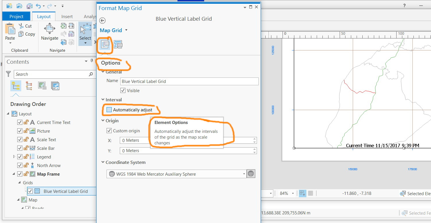

I couldn’t figure out how to edit the value of interval of grid in ArcGIS Pro.

By unchecking Automatically adjust on the Options tab Properties, you can change the Interval of x and y for Gridlines, Ticks, and Labels on the Components tab.
Modify Grid Properties - ArcGIS Pro

The issue at the moment is that the Pro fails to take the value of the offset. For example, as I set the value to be 50, it gets back to another random value.
What could be the issue here?

This is all fine except in my session the "Apply" button is greyed out and all my settings revert back to default.
