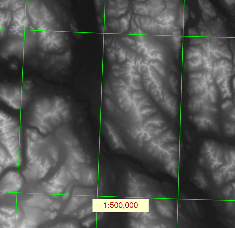

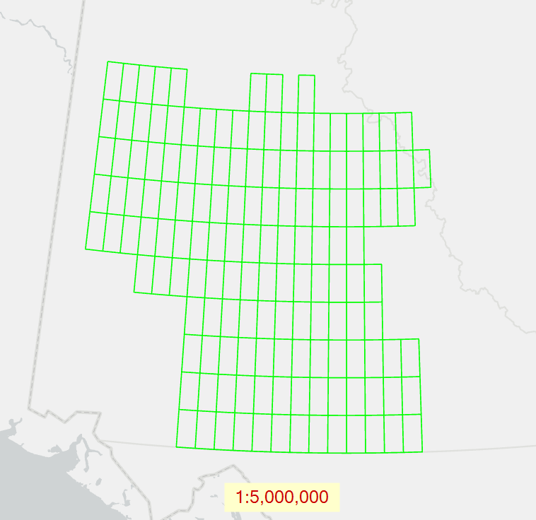

How to get Pro to display contents of a Raster Mosaic Dataaset at all scales (zoom levels)?
In ArcMap there was a preference to show only images a catalog when fewer than 9/16/.../999 tiles in display area. I haven't been able to find the Pro equivalent.

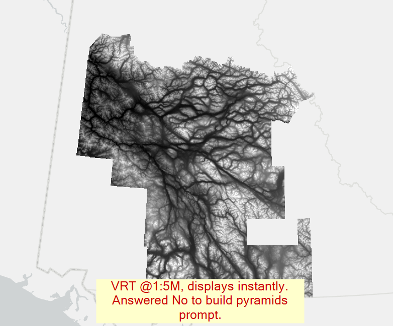

The source images are Cloud Optimized Geotiff, so there are guaranteed overviews for all scales. Here's a VRT of the same images, it displays in Pro near instantly at all scales after the initial few ~2 second load:

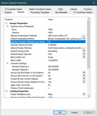

You should build overviews. If you must see original data (why?) there is property of max raster to show (default is 20) but this will slow the display
MattWilkie1
where/how is the max raster property set?

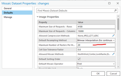

mody_buchbinder
It can be done in Pro, no need for ArcCatalog

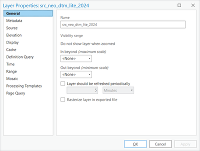

MattWilkie1
how are you getting to that dialog? I see something quite different:
MattWilkie1
doh! nevermind. One needs to use right-click context menu from a Catalog view or panel and not a Map view. Count me another victim of familiarity blindness.
