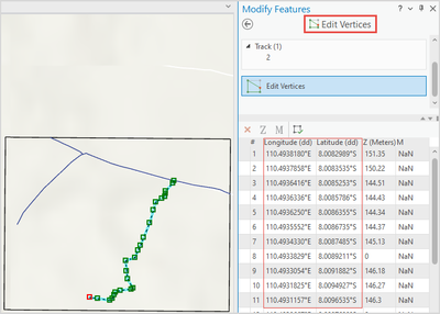

As explained in this How to Technical Support Article, it's possible to determine the XY coordinates of the (lines or polygons) vertices from Edit tab > Modify Features pane > Edit Vertices pane:
00N39000003LL2C-0EM5x000003dfeY
XY coordinates of the vertices are listed in the Longitude (dd) and Latitude (dd) columns, regardless from the coordinate system of the layer.
There is a way to list the projected coordinates if the layer Spatial Reference is a Projected CS?

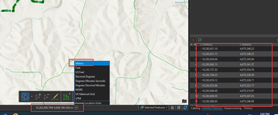

Hi @RobertoRossi,
1.  Set your Map's coordinate's system to a Projected Coordinate system
2.  Change the Map's units at the bottom to the measurement of your choice
The Edit Vertices should now reflect this.  Ex:

RobertoRossi
Thank you very much @JakeSkinner !
I was missing the second step (the Map Unites choice)!
