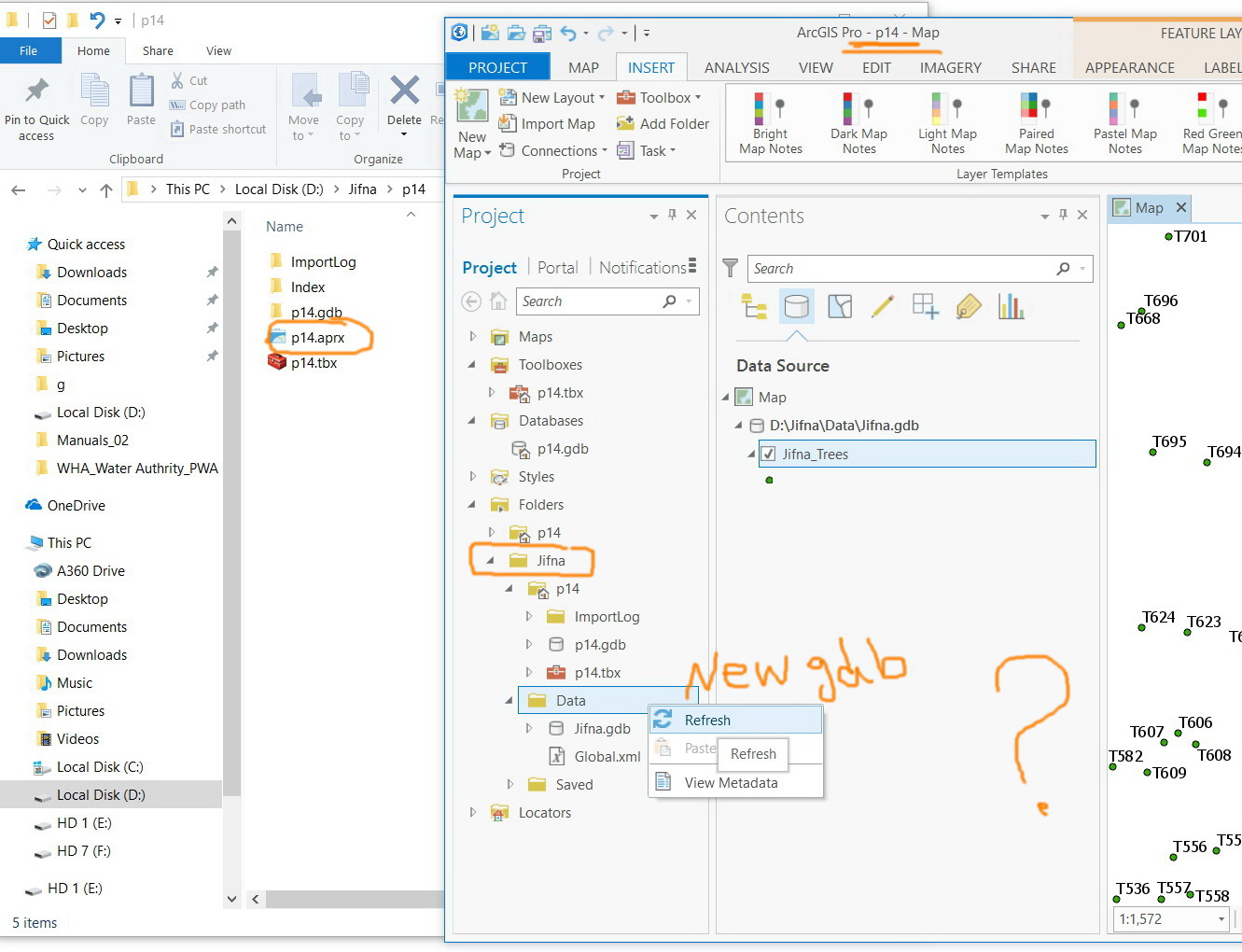

It appears that the ArcGIS Pro doesn’t detect the subfolder.

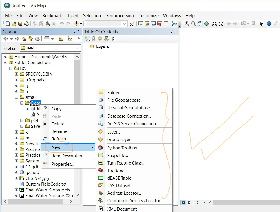

In the screenshot below, I wanted to create the gdb inside the Data folder that is contained in “Jifna” Folder. This appears to be impossible. Am I correct? Why this should be a challenge in ArcGIS Pro considering the fact that ArcMap has been existing since long time ago with all these features available.

I can see Sub-folders, so it seems to be a permission related issue in your case. R-click on that folder and undo the read-only checkbox and show the folder. Then check again.

Despite the fact that Jifna folder has the same permissions as Data folder, ArcGIS Pro fails to recognize Data folder. However, granting Data folder more permissions solved the issue.
