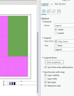

All,
A colleague has created the following legend in ArcPro from a polygon dataset using unique values, so this is not a raster colour ramp. We simply turned off border display and change a legend property to reduce the gaps between the patches to zero.
But the client wants the symbology to be horizontal, here is a crude cut example by me using MS paint of what they want:
I can't work out for the life of me how one rotates the items in the legend to be horizontal, any carto experts out there with a killer solution?

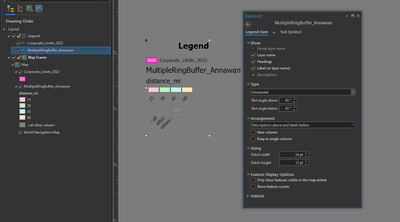

Here we go: with the legend item selected in the legend portion of the TOC, there's a dropdown on the element pane for 'type':
I just tested this out with both unique & graduated symbology and it worked.

Ahhhh! I did not have the layer selected in the legend in the TOC, so that option did not appear.
Nice one, thank you so much! Here is a well deserved virtual 🍺.
