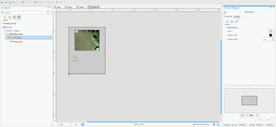

Just add a shape (rectangle)
Set the color of the rectangle and move to the bottom of the layout Contents drawing order:
