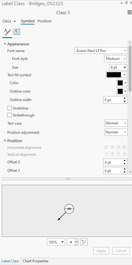

I am trying to create a symbol style with two lines, one line from one data field. I used Python script [field1]+"\r\n"+[field2] to create multiline labels, but I don't know how to control the alignment. As you can see in below screenshot, some letter B are aligned to the left and some are aligned to the right.
I tried to change label symbol position setting, but the alignment setting was greyed out. I am using Maplex Label Engine. Is there any way to adjust this?

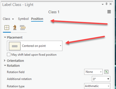

I see the same thing unless I select "centered on point".
R_

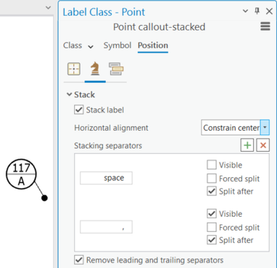

When labeling with the Maplex label engine, horizontal alignment is set by the label engine. Use the Maplex Stacking controls to constrain the alignment to center.
PaulLohr
There could be an explanation, but horizontal alignment seems poorly implemented. So users have to figure out that the stacking separators, which are added by default when the stack label option is enabled, should be deleted if they aren't needed.
