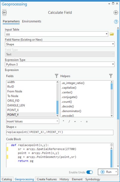

I've just had a play with Arcade and I too could not achieve the updating of the Shape field; may be it's not possible or if it is, it is not well documented as I could not find anything on the Help file.
That said it is completely achievable with python, this worked:
The code block is:
def replacepoint(x,y):
    sr = arcpy.SpatialReference(27700)
    point = arcpy.Point(x,y)
    pg = arcpy.PointGeometry(point,sr)
    return pg
