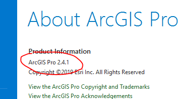

I also have this problem still. I am using a concurrent license- Basic-I just tried in Pro 2.4.1 and the problem still persists even now.

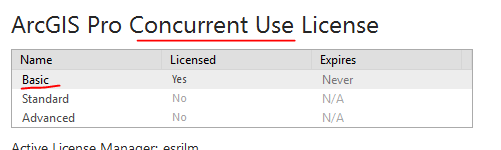

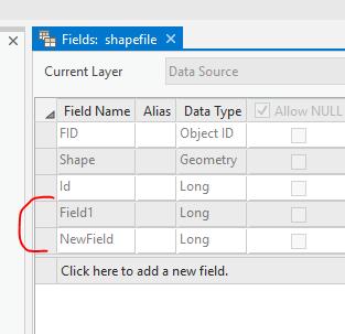

Are you certain that you've installed Patch 1?
If what you're seeing is related the the bug referenced above, it was addressed in Patch 1: https://pro.arcgis.com/en/pro-app/get-started/release-notes.htm
I just tried:
and was able to add a new field to a shapefile using both the Fields View (UI) as well as the Add Field gp tool:
