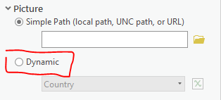

I have a point layer within my map that I would like to turn into a map series that focuses on each point. The point layer contains related images that I would like to display within the map layout. Is it possible to include these image attachments within the map layout? When I add an image to my current map series, the dynamic image section seems to be grayed out.
Thanks.
AubriKinghorn
Hi!
As long as you have a spatial map series set up on your layout the dynamic option should be enabled. It make look slightly confusing because the box remains greyed out until you pick the Dynamic radio button.
Bookmark map series, and layouts without a map series, don't support dynamic pictures so the option is greyed out.

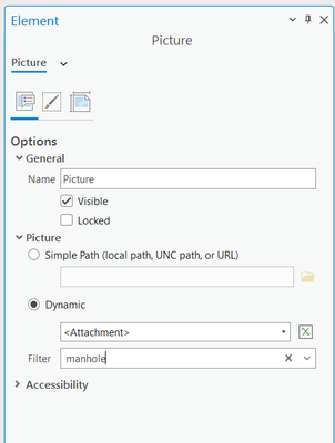

i have a point geodatabase for the manholes, it have two attachments, one is showing manhole lid, another one images showing inside manhole, so i need to show both images in the layout sheet in the dynamic images as attachment in ArcGIS pro, it appear only one image usually
AubriKinghorn
To do this you need to add 2 dynamic pictures, each picture element can only show one attachment. You can apply a filter on each dynamic picture to pick which of the two attachments is shown.
