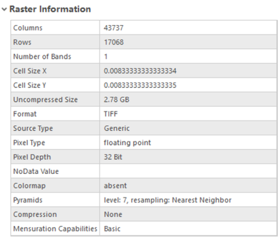

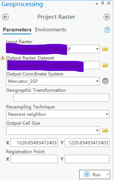

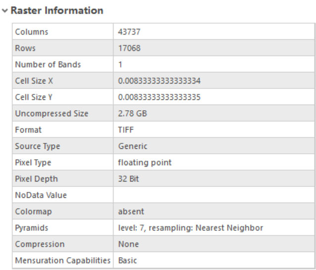

Hi. I am trying to project a raster layer from GCS - WGS84 to PCS - Mecator_2sp. I used Project Raster. The parameters are as follows. I found the cell size was changed as well as the value range of the layer. How should I set the parameters and solve these problems?
The information of the original layer
