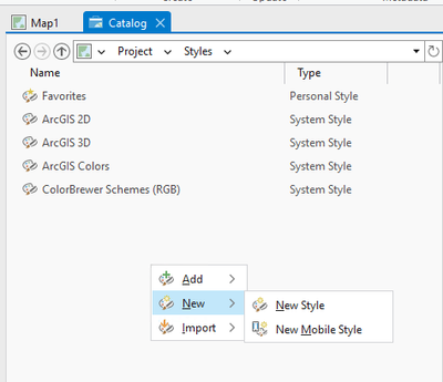

I think you want to create a new style with only the symbols you want to export.

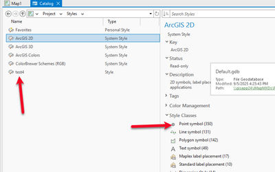

So, in catalog, double click on a style and it will open the style manager.  Right click and add a new Style:
Then, you can open the style that you used for the map, expand Point symbol, hold shift to select the symbols you want, right click, copy, go back to syle manager, right click on the newly created style, and select paste.
This will add the point symbols to new style that can now be shared and only contains the intended symbols.

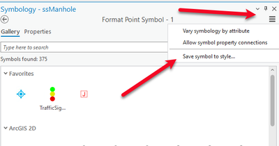

So, for this method, follow the above to create new stylx file, then go to the symbology tab for that layer.

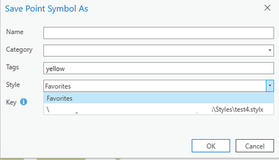

Click on a symbol and in the upper right waffle, select Save symbol to style:
Give the style a name and select the new stylx file:
Repeat for the other 4 symbols and you now have a style file that can now be shared.

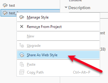

See my post above, then you can right click on the 'new' style and 'Share as Web Style' to share with AGOL.
