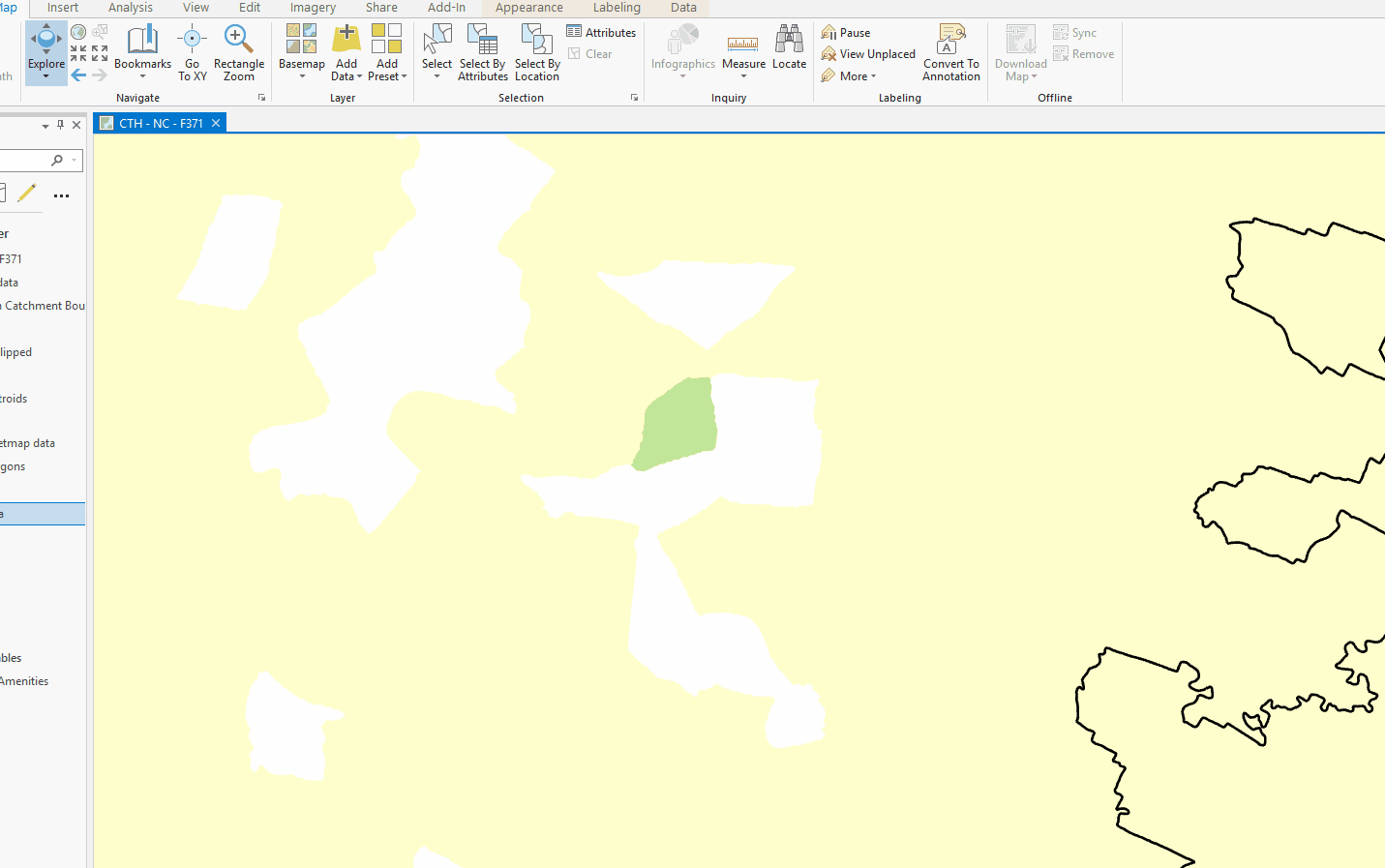

Jared Sellers‌ I agree with Joseph Howell‌ this ctrl approach does not appear to be working? I am using ArcPro 2.3.3. See video below, first I confirm I am querying the selected layer in the TOC, then I do a single click and the pop up appears, then holding down crtl I draw a dotty box with the explorer tool and nothing appears, not even an empty pop up? So what am I doing wrong?
Screen shot

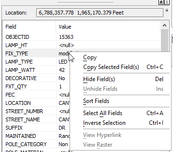

One thing I am not seeing with ArcGIS Pro Pop-ups that I like in ArcMap's identify tool is the context menu you could get when right clicking the attributes displayed in the window, allowing you to copy attributes among other things. I don't see that with Pro besides the coordinates at the bottom of the popup. I can highlight attributes and use the CTRL C on my keyboard, but its not as nice of an experience as in ArcMap for this particular need. That said I am getting used to the multi-functional Explore tool and using CTRL to drag a box over multiple features seems to work fine for me, at version 2.3.2.
 Context sensitive Identify window in ArcMap
