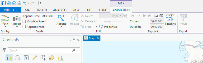

That's odd, there should be an animation option under view:
When you hit "Add" you get this, with a timeline at the bottom:
Maybe you're using an old version?

I would also guess it's the version. I think animation was added at Pro version 1.2. See this help topic, under the Mapping and visualization section: What's new in ArcGIS Pro 1.2—ArcGIS Pro | ArcGIS for Desktop
RichardWeber
To all who responded to my inquiry, thank you.  It was the version and now I am up an running.  Thank you all.  The question has been resolved.
