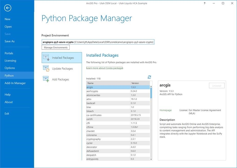

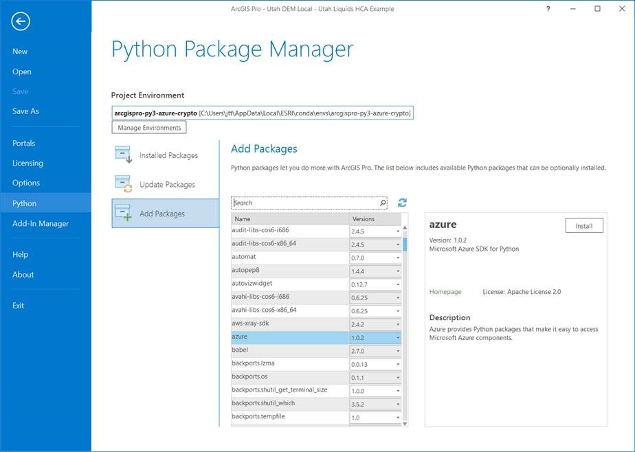

I need access to Azure 4.0.0. There is (of course) a pip install available, but no conda install (highest version for conda install is 1.0.2). Accordingly, I created a cloned environment, and installed from the command line via conda and pip:
activate arcgispro-py3-azure-crypto (my cloned environment; pip is already in this environment, however, I did upgrade pip to 19.1.1.)
pip install azure
When I list packages in conda, everything looks fine:
Results of
However, when I look at the environment in Pro, nothing is there:
Installed Python packages
Available Python packages
Everything is working, which means the conda listing is correct (and the packages are installed in the appropriate envs directory, but not in the pkgs directory of <localappdata>\ESRI\conda), but it’s just not showing up in the Pro Python Package Manager. I did a little digging around, and it looks like the Python Package Manager is actually reading the above contents from C:\Program Files\ArcGIS\Pro\bin\Python\pkg-metadata\metadata.json.
