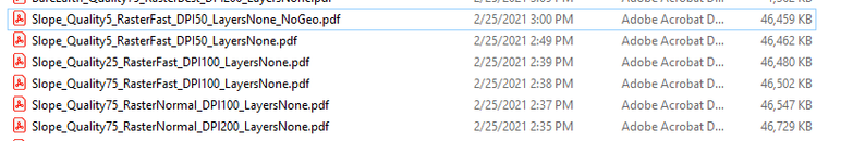

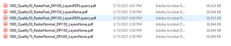

I've tried a lot of different settings, but none of them seem to have any impact on the file size.  Witness the two snippets below.  These are all 8.5 x 11 Layouts.
Does anybody have any ideas of how to get the file size down?  I know that ArcPro makes a larger PDF than ArcMap, but this seem ridiculous.
